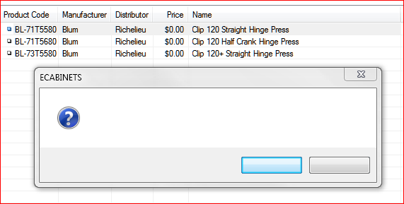

Second, I tried to change the file picture attached to a straight arm hinge with an accurate one. and after 10 error dialogs in a row received this one which required using tskmgr to close the app an lose my changes. What am I missing and/or doing wrong?
Hardware Error.PNG (23.06 KiB) Viewed 8675 times
EDIT: There were additional blank dialogs buried under the main window that became visible when app was closed. It took multiple tries with tskmgr to close these also. eCabs wouldnt restart before OS was rebooted. Upon reboot and restart of eCabs, all changes made to Hardware Mfgrs, products, websites, Vendor info was lost.
