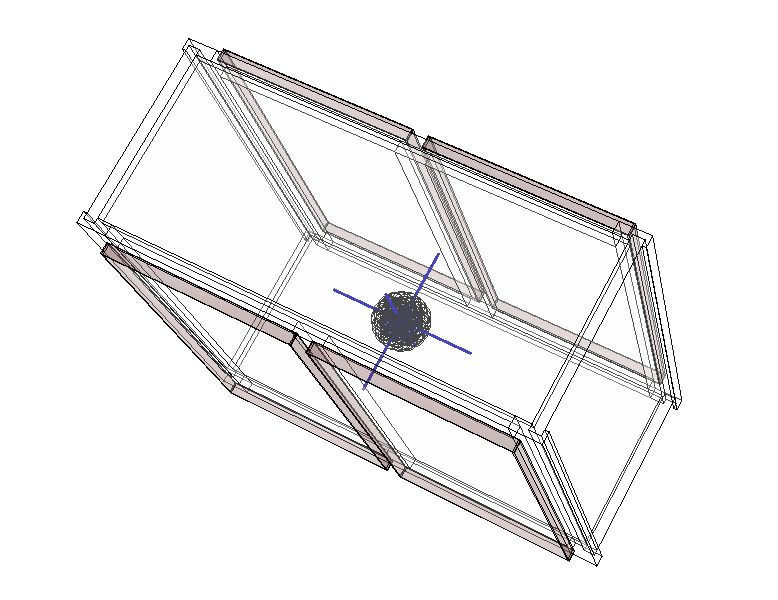

Here is one way that I do it.
I make up the cab. that I want then copy it then just us the face frame and doors on the back of the first cab.
Test Cab_11-3-10.esa
(562.02 KiB) Downloaded 338 times

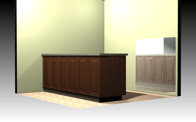

Re: Doors on front and back of cabinets
Here are some base cabs I did with doors on the back. The "Front Cab" has no back, and the "Back Cab" also has no back and the depth is set at 1/32". In CL, place the cab then rotate it.
Two sided cabs.esj
