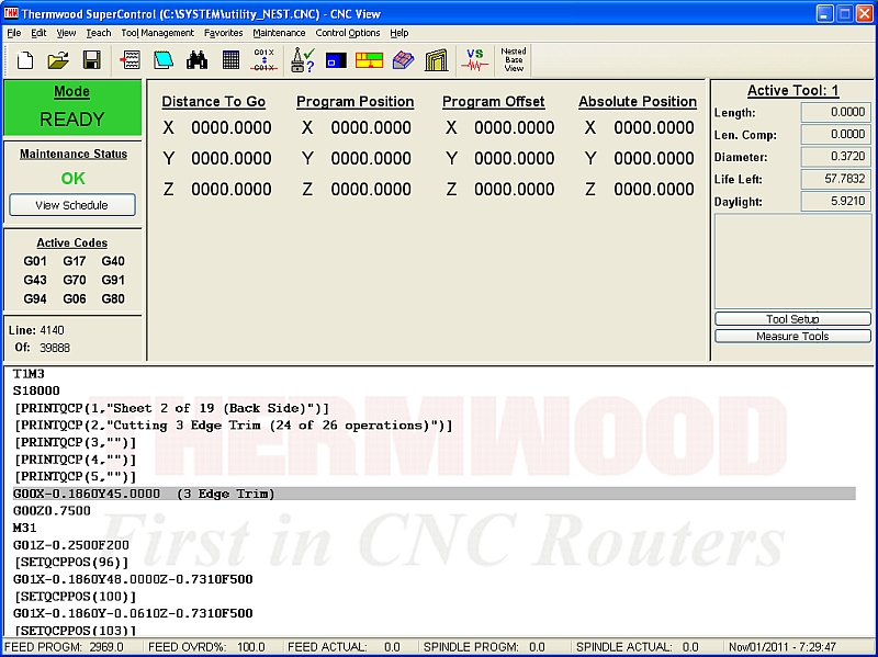

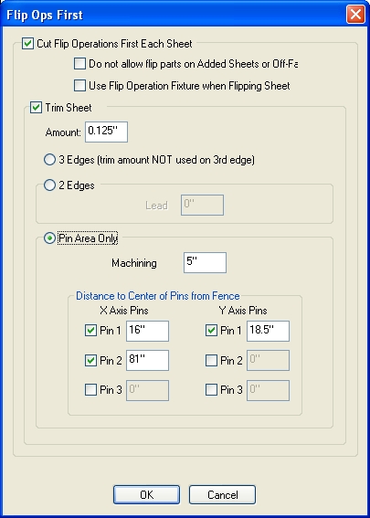

Under Flip Ops First I select Cut Flip Operations First then Trim Sheet and then select Pin Area Only
When I look at the code it is trimming 3 Sides Not just the pin area

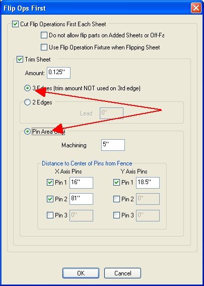

I then notice I can select more than one radio button in the flip ops first dialog

I only want to trim the pin area of two edges but after updating control nesting to version 5.66 that is broken.
If I selected Trim Pin Area only the machine did not trim anything.
