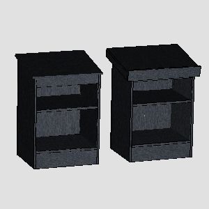

Hi Michael
Here is a basic lecturn design I was playing around with.
I havent a machine so it has not been tested.
The top would have to be fixed from underneath
The angle is about 10deg

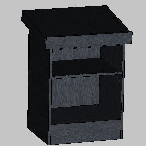

Post by Dennis G. Blackburn »
Yes - it's possible. Thermwood built this one for me "on the fly" at the 2010 IWF Woodshow in Atlanta.

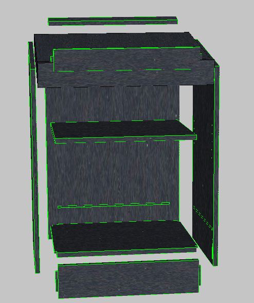

Re: building a podium with an angled top?
Sorry, I didn,t show the blind dados.
Just need some sash cramps and glue and your good to go.
Perhaps replace the back rail with a bracket or you can turn on or off, and adjust the dados to your liking in construction settings
Lecturn 2.jpg (10.37 KiB) Viewed 13362 times
Michael,
I don't think you will be able to addd the blind dado or kd/rta joinery to the top is it is angled. you can't add joinery to any angled parts unless you do it manually in the part editor.
Michael,
I hae been in Colorado all this week and yes we did get snow. I don't hink it was as bad in Dalhart as they had expected.
about 6 or 8 months ago I had to do a "widget" for Keith that required joinery on an angled part exactly like what you are needing for the podium. I was able to do it using a stretcher but there were some wierd little ticks in the nest that the machine was trying to cut using an eighth inch tool. When I reported this to Scott he thanked me for finding a bug. He said that the software should not have allowed me to create the joinery. Untill the next release when this bug is fixed I guess it would still work. I will give it a try tomorrow and see if I can do it again.
