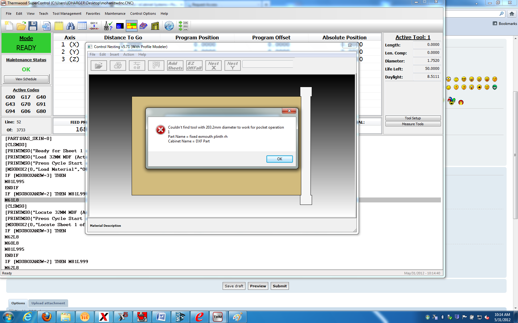

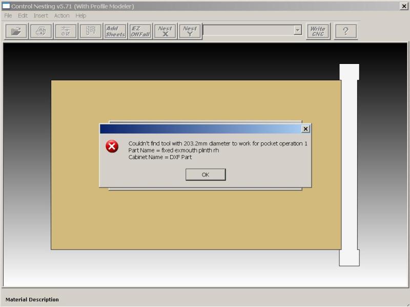

outline is ok but pocket tool is searching for 203.2 diameter tool inspite of setting it at 8.0mm tool so its multiplied by 25.4 and in imperial 203.2 so cannot use this dxf option again
iam attaching all the needed files please thermwood techs have to look into this asap!!!!!!!!!!!!!!!!!!!!!!!

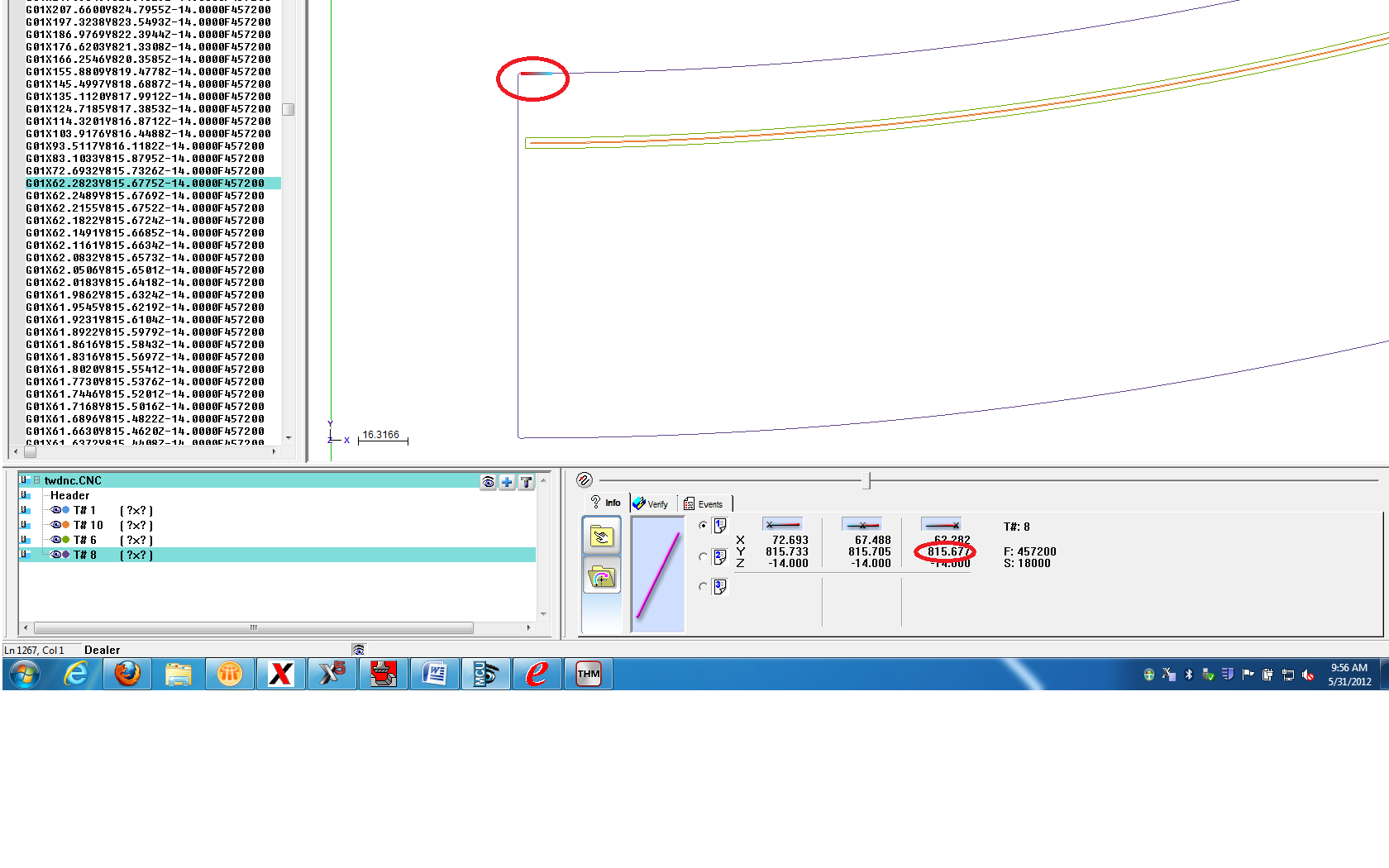

Mohan, I have done some looking into your problem you are having...If you look at "sizefromtwd1 and 2" pictures you can see that the code from the machine is outputting the right dimensions. Is it possible that the wrong tool is in the holder? The measurements/code show up good here and is being compensated with a G42 which is correct according to the "Conventional" tab you have selected.
Measurement showing start point (815.677)
Measurement showing start point (695.677)

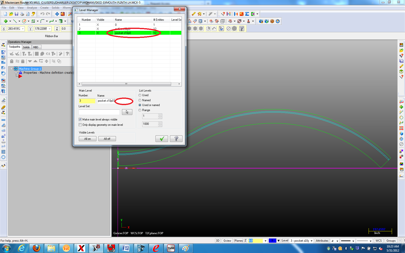

About the DXF file....the dxf file you have EXMOUTH PLINTH LH.DXF....we can see you have d8p0 tool defined to cut with (picture dxf_8mm_layer),
but in tooling there is no 8mm tool set up...There is a 7.8mm tool set up and your tolerance is at .2mm. With this settings we are getting the error..(This error message is indeed incorrect >>it should read 8mm tool), but it is still looking for the 8mm tool.

If I change the tolerance in tooling to a little bit past .2 to .21 then it nests fine as is.....
If we set up a 8mm tool and leave the tolerance as is at .2mm then it nests fine also...
Also, if we take out the d8p0 in the layer name then it nest fine as well

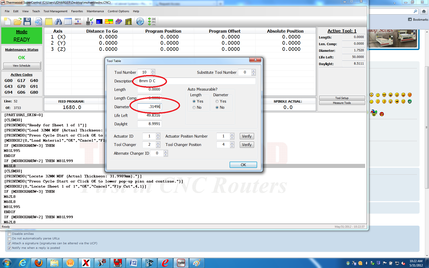

ihave also checked this tool holder and setup its all set ok and the tool diameter is 9.5mm i have uploaded the cab file but can also check herehttp://www.thermwood.com/forums/viewtopic.php?f=7&t=12928

coming to dxf same issue there is no problem on you CN but on our CN its showing the tooling error please look at the image in this post tool asking for 203.2mm tool instead of 8mm.
