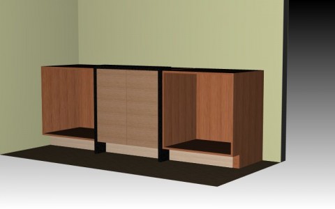

Re: Several Different Construction Questions
I am still not having any luck. When I created the display object that is the first piece of trim, I can rotate it to get it facing correctly but I still can't figure out how to get it to move.

Scott Moffett
- New Member
- Posts: 10
- Joined: Mon, Oct 01 2012, 11:25AM
- Company Name: Scott Moffett
Dennis,
Thank you. I tried creating a display object and a display cube and I am able to move them around left and right and back and forth to place them in front of the cabinet. What I can't figure out now is how to get them to move up and down in the room. Both objects I am working with are 88" long, 3" wide and 3/4" thick. The display object came into my layout half below the floor and half above. I can move it where it needs to go now but can't get it to raise up to be flush with the top of the cabinet. The display cube is at least all above the floor but it is resting on the floor and I can get it in the right position also but again I can't get it to raise up to be flush with the top if the cabinet.

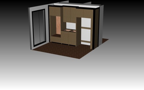

Scott Moffett
- New Member
- Posts: 10
That worked great. I made display cubes and using association and the moving techniques I was able to do it. Now I am going to do the short wall.
Thanks for the help. I still have so much jury rigged to get it to look right that I don't know if the software will help much actually figuring out cuts and pieces but at least I have a good visual representation for myself and the client.
