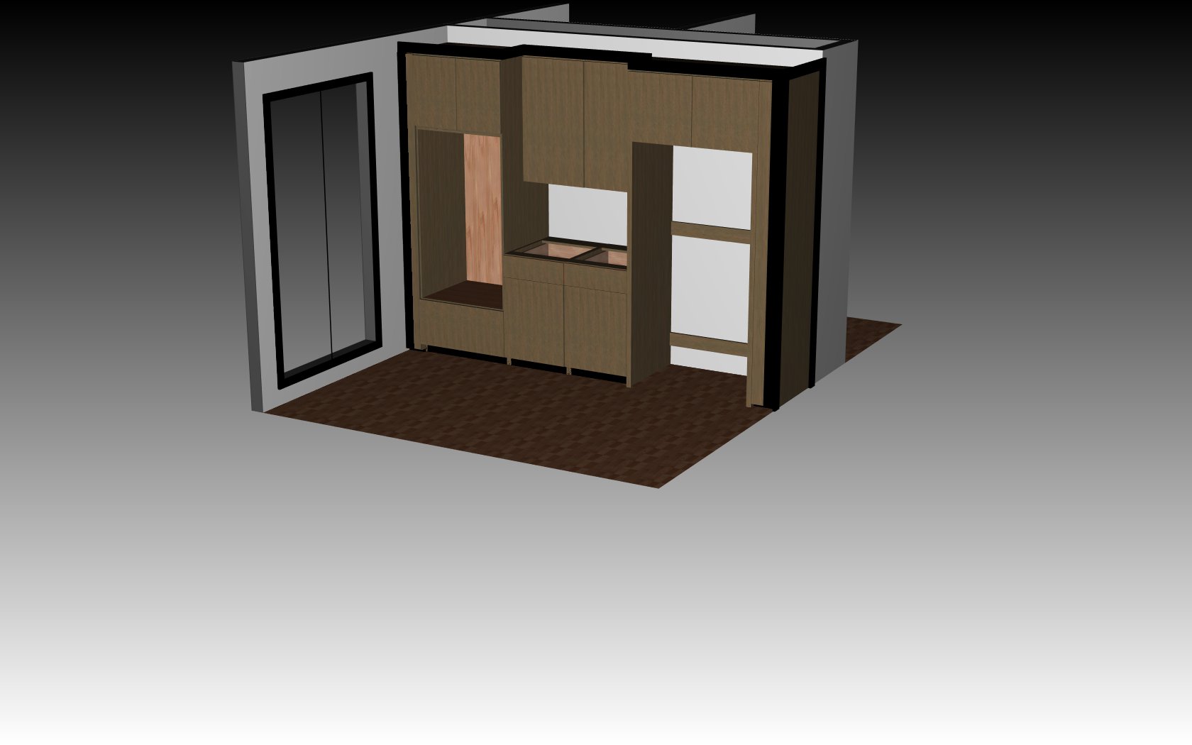

That worked great. I made display cubes and using association and the moving techniques I was able to do it. Now I am going to do the short wall.
Thanks for the help. I still have so much jury rigged to get it to look right that I don't know if the software will help much actually figuring out cuts and pieces but at least I have a good visual representation for myself and the client.
Also, how do I get a larger, closer up picture? I am saving the the JPEGs at 100% in the presentation view and you can't go higher.
Scott
