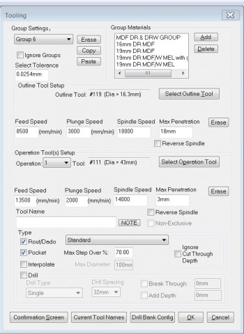

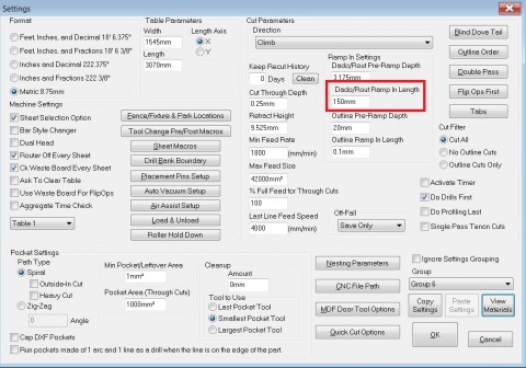

We also use a flycutter type tool for pocketing on mdf shaker style doors, and we were able to lengthen the tool's ramp-in length by changing the rout/dado length setting
Below are our tooling settings for the pocketing tool.
