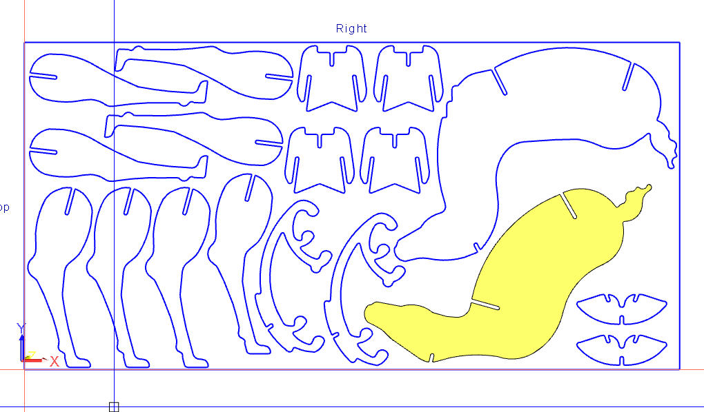

When I chose the part out of the nest and click closed contour shape, then go to the bottom and click NEXT the Next button changes shape with a box surrounding it, but the next button doesn't ever go away. It just stays there. The other parts the NEXT button would disappear and then the part would pop up out of the nest.

I'm not sure why one body won't work, but you could just copy and paste the other one
Damon Nabors
Posts: 923
Location: Marion, Ar.
Post by Damon Nabors »
They are two different bodies, one is leaning down and the other is looking up.

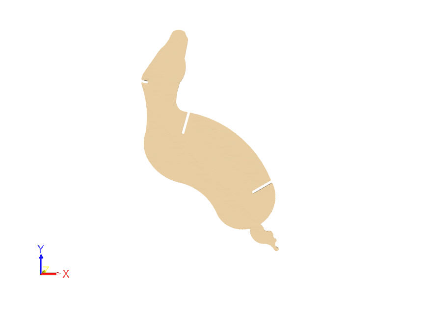

Try doing a chain select on the other body and see if it has any open contours.
Here is an x_t file that you can use to create the other deer.
OneDeer.zip
(27.81 KiB) Downloaded 834 times
deer 2.jpg (20.68 KiB) Viewed 13743 times
deer 1.jpg (126.71 KiB) Viewed 13743 times

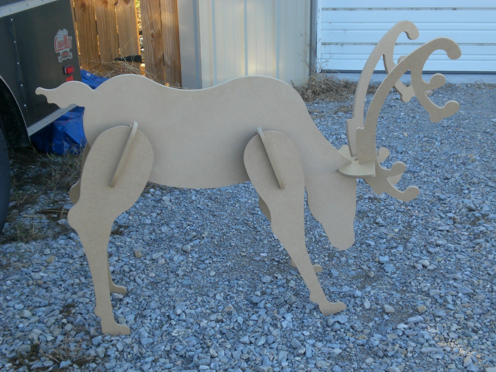

Thanks Dan and Joe,
We have repopulated another Deer
grazing deer.JPG (926.88 KiB) Viewed 13723 times

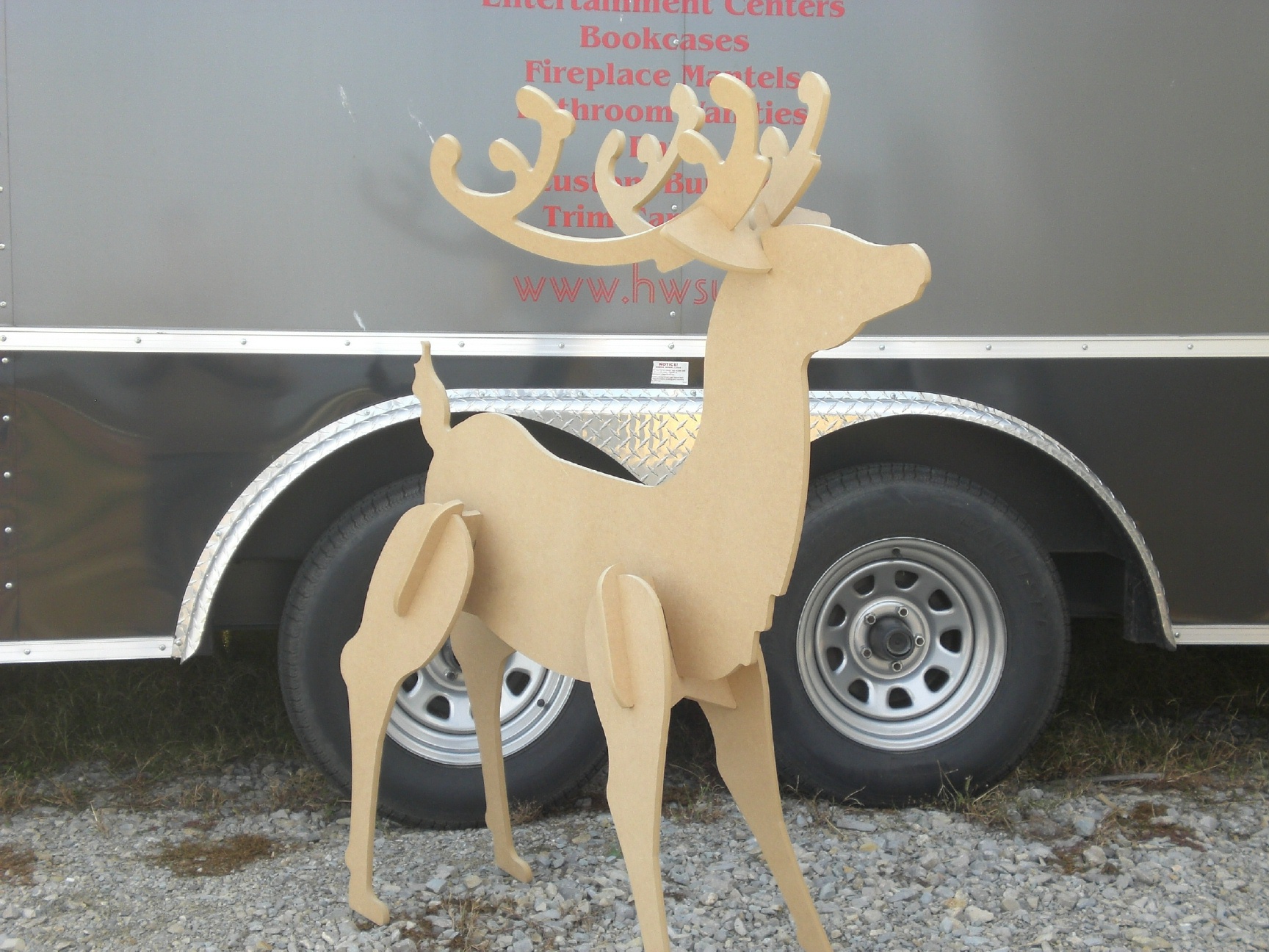

Very cool Damon. I may have to make some for my grandson. Extira MDF would be good for these although expensive.

These where made from scrap. I am still toying around with the router since we have only had it for a week now.
If I where going to make some to keep, I would make them from 1/2\" MDO.
Sign makers use it all the time for exterior. I think a 4x8 sheet of 1/2\" is $35.00. Thats not too bad, $17.50/deer.

I wonder if MDO is the same as Extira. Also, 3/4\" may be required for fit. Looks great. Keep it up.
