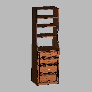

I have attached a cabinet that I am trying to add a 2.5" stretcher to the bottom front of the cabinet as a TK. I want this TK to be inset .25" with a KD/RTA fitting on either side. What I have done in the past is give the front inset of -1" for both the Right and Left KD/RTA Placements and the back @ 1.25"
As soon as I do this, I lose all KD associations and Dwr Slide associations. Then when I go to the associations and re-apply the slide associations it will add them back but then when I add the kd associations the slides go away. :wall: :wall: :wall:
Any ideas what is wrong with this cabinet???
-John

I just took this cabinet in and added a TK in the construction settings and when I came back into the cabinet editor, it lost all the hole associations.
This doesn't make any sense to me!!!
