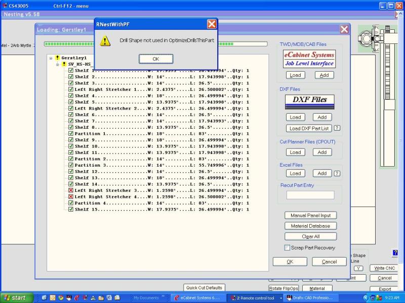

This error came up when loading a job into CN just after I clicked OK to next: Drill Shape not used in OptimizeDrillsThisPart
I had to click the ok of the error about 27 times and then it moved on.
Interesting thing is that when I reloaded that cabinet in a batched job this error didn't come up.
Any ideas?
Drill Shape not used in OptimizeDrillsThisPart.JPG (97.08 KiB) Viewed 6786 times

FYI, here is what I found out from the Thermwood guys. This actually isn't an error! :oops:
John,
The dialog you are seeing is not really an error. It is informing you that 2 drill holes on reverse sides of a piece are intersecting but are not exactly over each other therefore it cannot drill straight through. It will tell you this for each and every set of holes.
