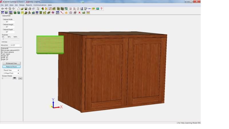

More information - when I take a cabinet from this job into cabinet editor the appendage is still on the screen. IT'S ALIVE!!!! :shock:

One more note - the appendage does not go away in presentation mode. It's going to be tough showing this to the client... :(
Thermwood - could you help me get rid of this appendage so I can show my client?

Here is the fixed file.

Well, I guess the easiest way to fix it in the current version is too:
1. draw a wall in the job big enough to place 3 cabinets
2. place std base frameless on each end of the wall, then place one in the center of the wall
3. select the center cabinet and choose expand to fill
the appendage should disapper.
4. delete the cabinets and wall you just created.
5. Save the job.

Thanks Rick! Worked great.

I'm glad it worked. This was just a work around. A bug has been found and will be fixed in the next build.
