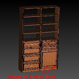

I would love to see this option as well because there are situations where I can't lay a cabinet on its side. Since we mainly do closets most of our cabinets are done with multiple sections. A tilt out hamper has its hinges on the bottom shelf and when the next section is a stack of drawers, the only work around is very time consuming.

Bryan I dont see why this should be a pain in the butt once you have created this unit and saved it in your library. All my work is done in custom layouts and I use this solution all the time.
John i am not clear as to what you are trying to achieve, perhaps you can give an example and I may have a work-around

Nick,
Here is a jpg and an hsf file that shows a hamper door which is hinged on the bottom shelf and is surrounded by drawers. I cannot do this design to be cnc'd just by rotating the cabinet. The "work around" that I use is creating a contoured pattern from a rotated cabinet.
-John

Bryan that configuration must be exceptional in which case I would create the holes in the PE.

Bryan I was referring to the example given by John, the solution of a cabinet on its side works just fine for upper level cabs
