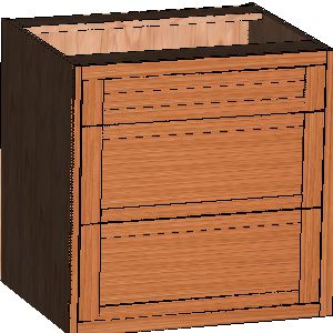

I believe I have attached the file, let me know if you cannot load it.
Thank you
3 Dw Base.jpg (23.14 KiB) Viewed 13830 times
Re: Cabinet/Assembly Editor causes ecabinets to end
That's just the jpeg. It needs to be the HSF file.
