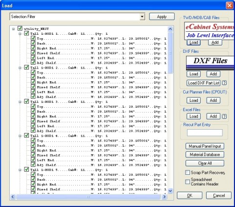

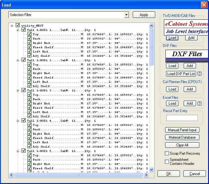

Re: Batching Problems
Download files HERE
Open the job file in ecabinets
Click CNC
Change 3/4" maple material thickness to .730
Change 5/8" maple material thickness to .610
Do nothing to mdf material
Save the .twd as utility_NEST.twd
Open the .twd in control nesting V 5.66
In control nesting I show 7 number 11 tall cabinets. There is only one in the job
