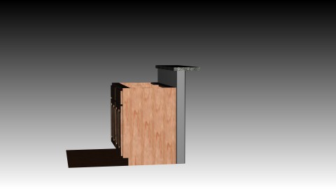

I would create a display cube for the counter top. It may be easier to do this in the cabinet editor. If you chose to do it in Cabinet editor make sure that you associate the display cube with the cabinet before returning to the layout.
As for the 22 1/2 deg. angles it would help if you posted the layout.
This was done using a display cube taking the cabinet from custom layout to cabinet editor and then associating it with the cabinet

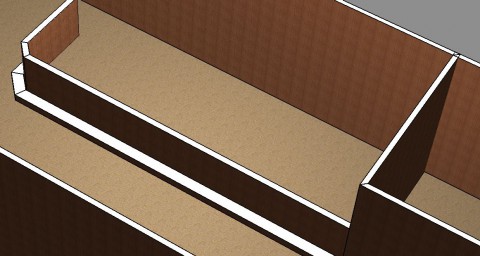

Scott Bleau
Posts: 3
Joined: Sun, Dec 22 2013, 8:13AM
Company Name: Northeastern Woodworking
Re: Two Level Bar; Elevated wall construction?
Post by Scott Bleau »
Thank you Scott. That worked great. I've attached an image of the bar and toe/foot rest that I created previously using the wall tools. If there is a way to "cut" the display cubes at an angle to create the corner/turn, I think I'll have what I'm looking for.
Scott Marshburn
Posts: 867
Location: Jacksonville Nc
Post by Scott Marshburn »
Hi Scott
The way that I personally would do that would to draw the wall in 2d in another cad program.
Then create the geometry for the counter and save or export this geometry as a dxf file. Make sure that the geometry is oriented the same as the cube shows in part editor
Then take a cabinet that you wish to associate it too to the cabinet editor create the display cube. You will have to size it so that when it loads the actual top is facing the face of the cabinet or when you take it to part editor you will be looking at the ends of the part not the top .Click on the cube and take it to part editor. Click on contour mode and open the dxf file.
Make sure that all of the lines interest and then trim them.
Click on exit contour and right click and select create part using closed contour.
Click on the geometry and click next.
Then you can rotate it and use the align tool to position it where you need it.
Hope this helps.
Scott
