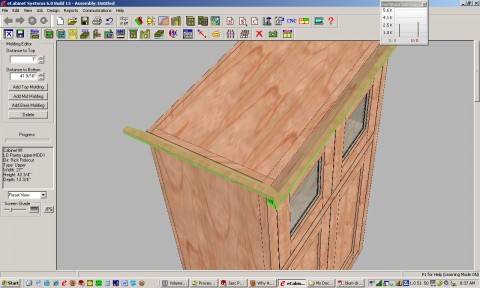

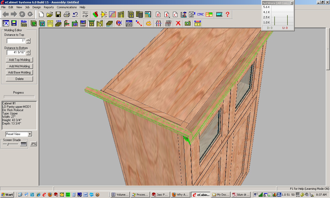

I have a cabinet that when you use the crown editor area won't put the corners of the crown together. The problem happens because I have face frame offsets for the side pc of plywood. This puts the plywood side in from the edge of the cabinet by 3/4". Then there is a panel that is applied on the plywood making it flush the the edge of the FF.
But the return pc of crown stays following the plywood. I can't get this crown to push out and look like it is wrapped around the panel. It is sunk inside it.
I can adjust the scribe of the front pc of crown to make that look correct, but not the return. That only has scribe functions for front and rear.
Am I forced to apply a pc of crown manually there? Or am I missing something?

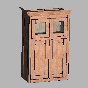

Hope this is it. It's so buried in the file structure of the computer
LO Pantry upper.hsf
(644.02 KiB) Downloaded 751 times
LO Pantry upper.jpg (15.34 KiB) Viewed 8179 times

Leo,
If you need it for looks, then yes, your best option is a display molding. If you did not need it for looks, it is the correct size already, just positioned over by the face frame scribe.

Ya, it's just for the presentation. I was wondering why my upper rail on the panel looked so fat. I zoomed in and the crown was buried.
