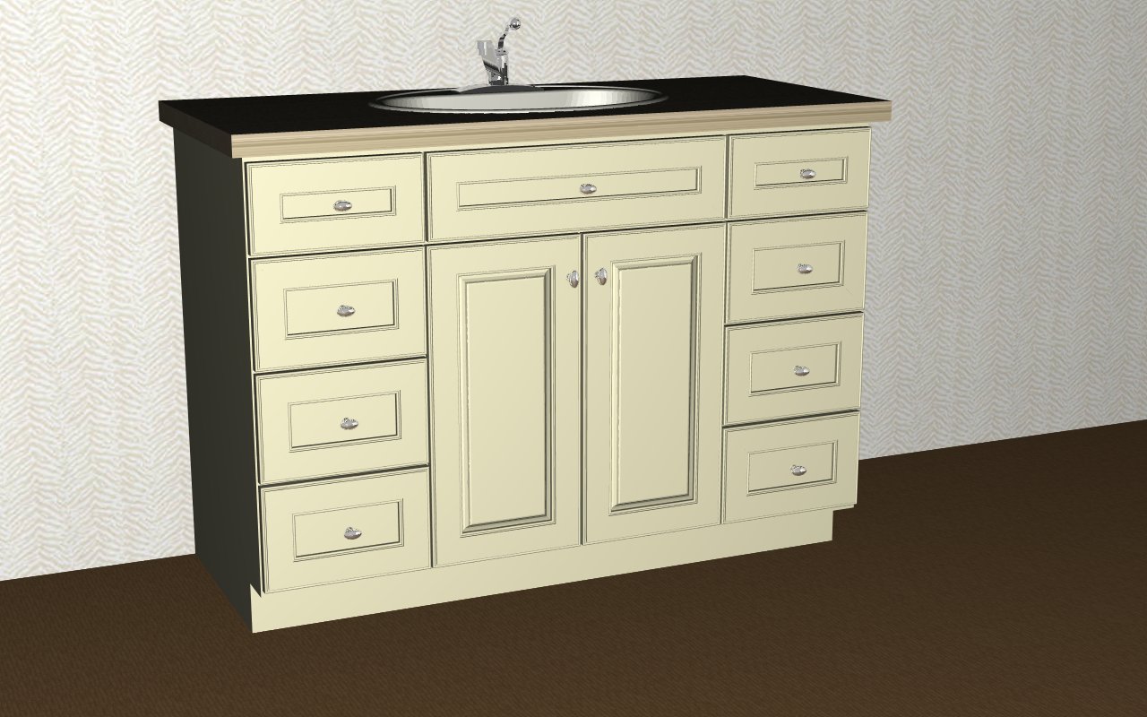

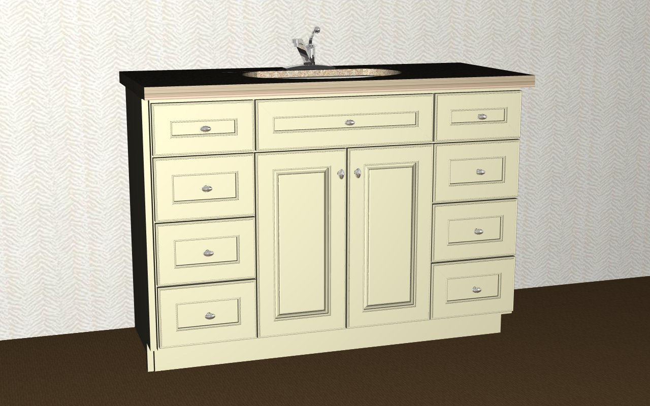

by Al Navas » Tue, Jun 05 2007, 1:51PM
Interesting...
1. Placing BOTH cabinets in the same room ---> crashes with same memory error.
2. Placing each cabinet individually in the room ---> works OK.
I attach the images I obtained from each rendering.
New vanity.jpg (150.93 KiB) Viewed 12895 times
Old vanity.jpg (147.24 KiB) Viewed 12895 times
