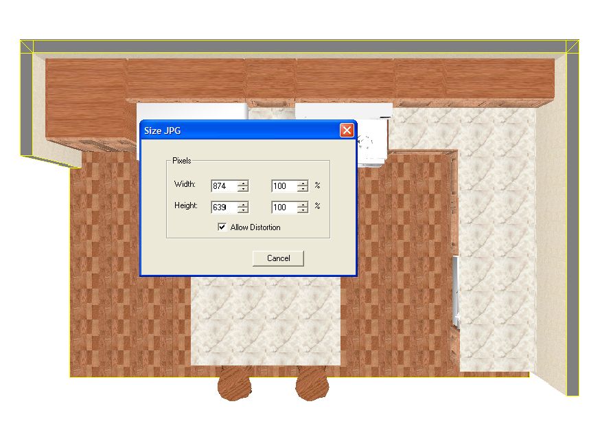

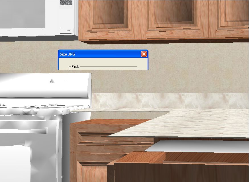

when I make my countertops one of them is floating above my cabs, also when I go to save it will get to about 34% and freeze, not responding so I lose any forward progress, in some of the jpg the diolag box remains
floating tops.jpg (72.13 KiB) Viewed 15945 times
Birds eye w tops.jpg (80.03 KiB) Viewed 15946 times

To solve the issue with saving, take one of your countertops into the part editor then return without making any changes. This will let you save the job without freezing up. This issue started with Build 3.
As for the countertops floating, it looks like your cabinets are a couple inches lower than the stove height. Is it possible they are setting below the floor a couple inches? I have had some do that if I took them back to the cabinet editor to make changes to them.
