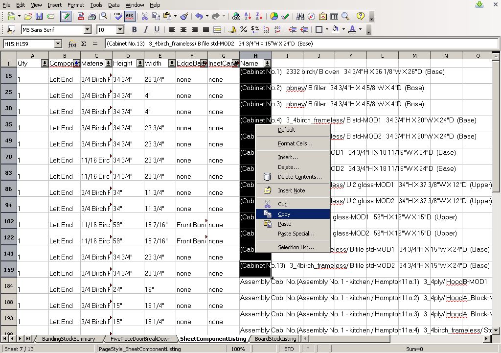

After I generate my cabinet drawings I produce a cut list and export it to excel. (Free Open office will open this as well)
Next go to the sheet component listing and sort the end panels or something you know is on every cabinet. For example in the picture I knew every cabinet had a left end so sort the left ends and this will list the cabinets.
Now look in colum \"h\" or the 8th colum highlight the first and pull down to the last so the colum is highlighted as shown. Next select copy from the right click menu or ctr \"C\"

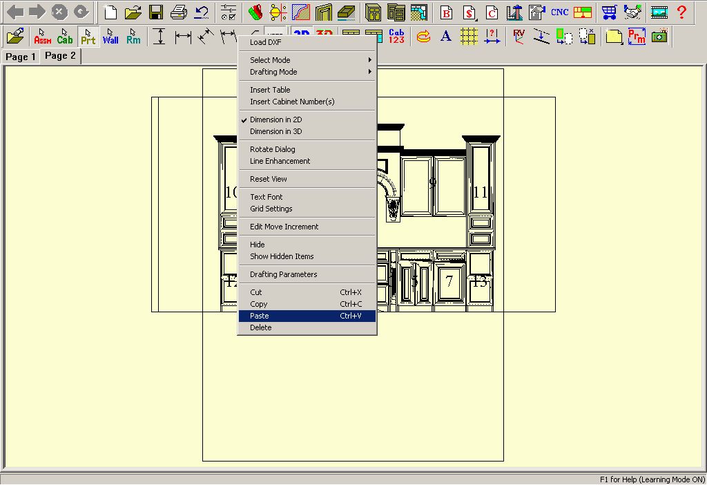

Then go back to the LDE and select the text button and right click on the screen and select paste...

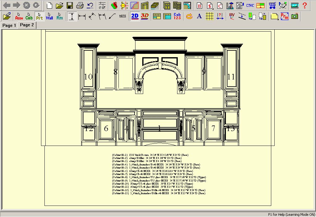

e_cabinet ststems will then start typing in the copied text..
