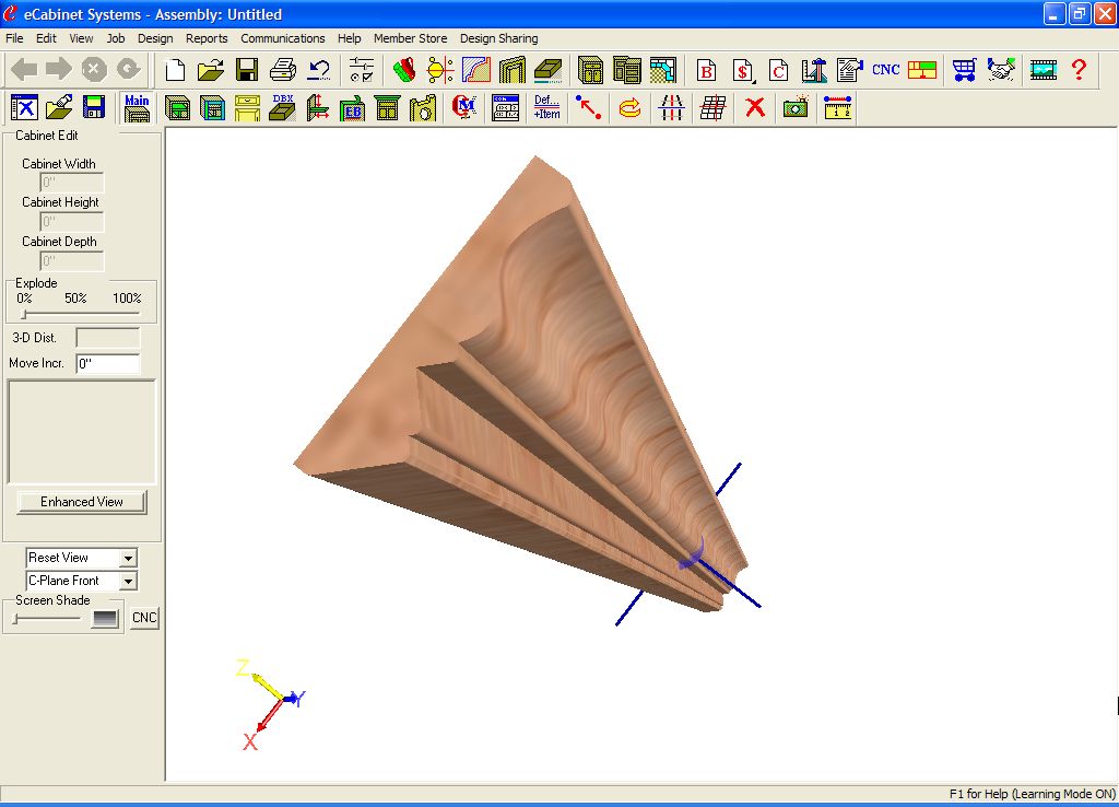

Brian Shannon
Posts: 979
Location: Los Alamos, CA
Post by Brian Shannon »
That worked Chris. Make a .tol(@5.5 dia.) using your .dxf. I used a display panel that was 5 1/2\" x 96\". Take the panel into Part Editor, select Profile Edge, single, click on the bottom of the left edge. Find the tool you just made and set the right offset to 2.75, plunge depth to 1 1/16. This is just a starting point but you will see how it works and get the hang of it.

Michael Yeargain
Location: South East
Post by Michael Yeargain »
Works fine.
Now you need to create the back cutter to get the proper profile, if you want to get that detailed with the molding.
For whatever it's worth the profile will show great unless you look at the top of the cabinet behind the molding.
You can also move the actual dxf import to the right by 2 3/4\" and save the tol file. Using move increment. Then you won't have to do the offset.
Overall great job.. :wink:
