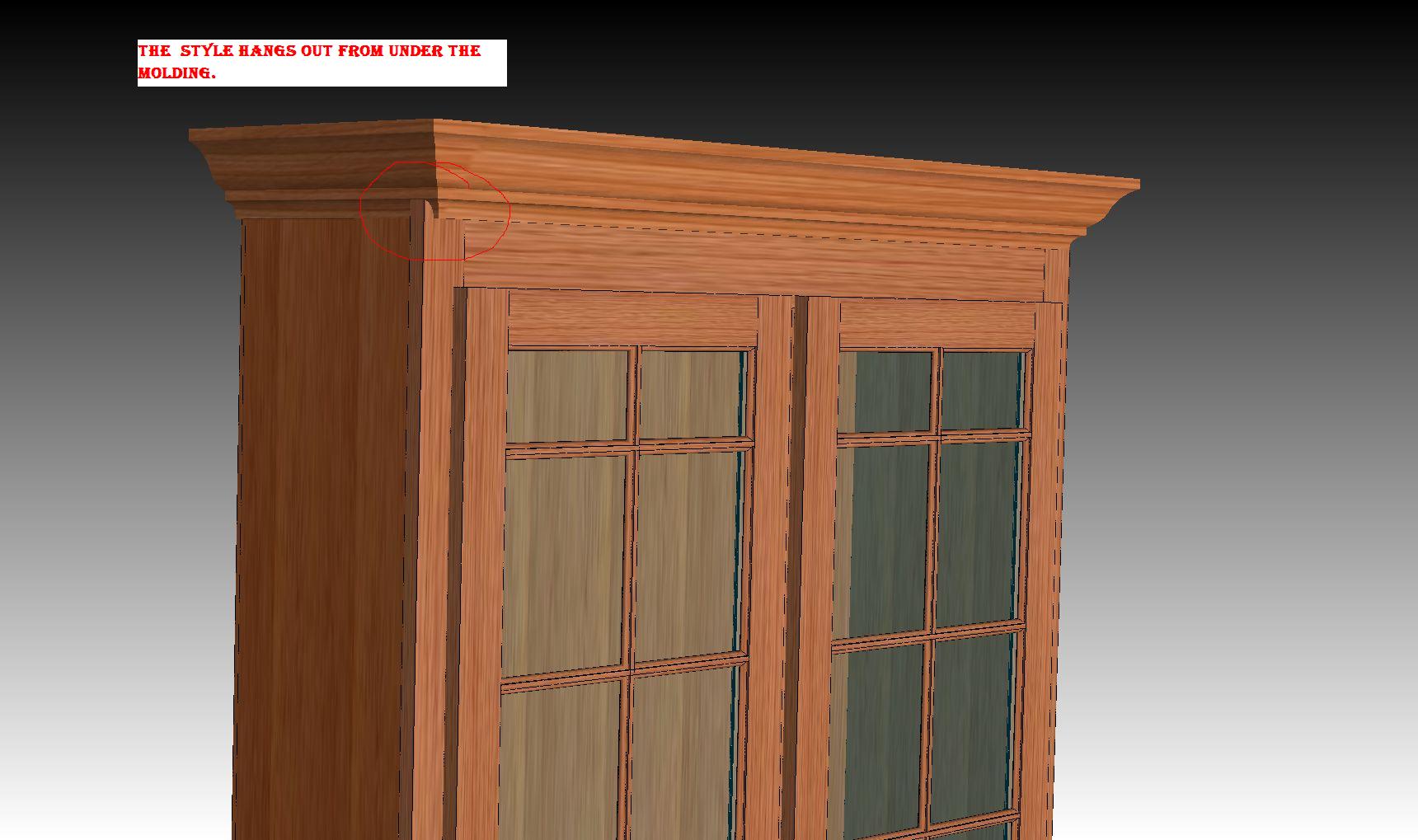

Is it the way I am doing it or is this a problem. When I have an upper cabinet and I plan to put a finished end panel on one end of the cabinet. I go to the face frame allow a left or right scribe of .75 to move the end gable inwards. The problem comes when I try to add the upper crown. It installs next to the gable and not the style. I understand why because it is a scribe, and I under stand that I can allow a left or right scribe on the front molding to bring it out flush with the end of the style, but other than bringing the side moldings in manually, how do you offset the side molding to line up with the scribed front molding? I know how to do this the hard way manually, but there has to be an easier way that I am overlooking.

Remove your moldings, set the scribe on the front molding then add the top molding. It will now have the correct positioning.
Nevermind that answer...it does not correctly place the side molding. You will have to manually place the side molding.

No simple way to do this. It would be a nice fix to not have to manually place these molding. To me it would be easier to be able to apply the moldings and if you want to inset the side gables be able to go into settings and inset the sides, rather than having to do the scribe thing with the faceframe.
Damon,
I leave the molding off the end of the cabinet where the finished end goes, then set a scribe to lengthen the top molding and add the end molding to the finished end with an appropriate scribe. You then have all the moldings when you add the end panel.

You know, there was another thread about creating a body-less cabinet with top molding so it could be resized. Everything but the top was deleted and molding was added. I'll see if I can find it so you will have another method to try.
