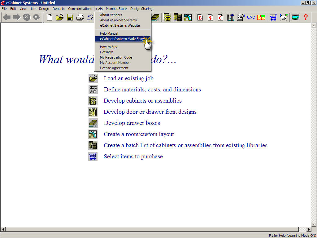

eCabinet Systems Made Easy (located on the help menu) gives a great tutorial on making curved parts.
Click the Contents tab then scroll down to \"Using the Cabinet/Assembly Editor\" and double-click it. Scroll down to \"Using the Part Editor\" and the right panel has the steps.

Thanks Dan & Paul: I haven't had time to play but this looks like what I need.
