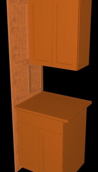

Brian, is this what your looking for?
Ell cabinet.jpg (36.66 KiB) Viewed 13940 times

Sorry, I forgot you wanted a shaker style.

Damon yes that is what I'm looking for ,but with two panels instead of one.one under the upper cab and one long one beside it. How does one go about making that piece also.?
Brian

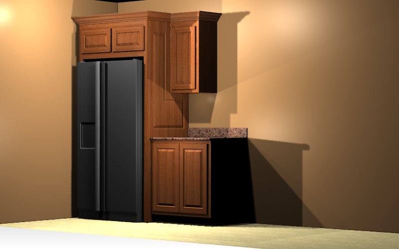

Brian, the first image, I brought in a display panel and took it to the parts editor and machined the raised panel. You can make pretty much any shape you want.
The easiest way to make two seperate panels is to bring in two doors and mesh them together to get the look you are looking for. In this picture I am using a 25.5" deep refridgerator cabinet so that my granit doesn't stick out there ( I hate that), and I placed a 12.75x34" door on the side of the cabinet and then placed a 24.75x 19" door just below the other door and lined up the styles to make them look as if they are one end panel. Oops, just noticed my back splash is not touching the wall.

Thanks Damon ,
I love it,the two panel wider at the bottom,great idea! i will put it in the proposal and see if it flys.Maybe i will pretty this one up and send it to jason for the next e cab mag.
