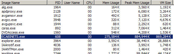

Well that really stressed out my PC!!! I'm giving it an Aropax and the rest of the day off. Ill try it on my Dell M90 next.
Re: Laptop
That job sure loves memory...885MB at peak with 869MB virtual memory!!! You're going to have to give up theatre Kerry. :lol:
I can manipulate it with only small delays. The delays are enough though that I would want to scream after a little while working with that layout. :wink:

What are you running that on Kerry? My Dell does not fall over but it is really unworkable

Ok kerry it gave my PC a work out. How about posting a file that can be manipulated on a normal computer that is challenging not something that will bog down a desktop. I want to use Ecab but if I cant manipulate a drawing this is not a good way to convince me to do it. :D

I am using a dell 380
Pentium 4 3.6 ghz
2 gig RAM (just ordered 2 more)
nVidia Quadro 4500 512mb with Dean's Quadro Tweak
That job slows this computer way down also. It has too many part editor cuts.
