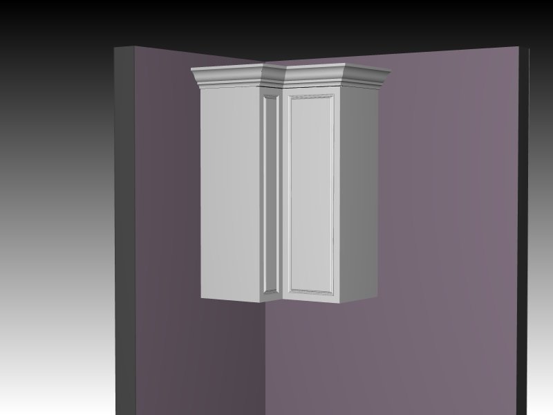

Hey Jean, I did the crown on a corner cab your way and placed it in a room and it worked. Did you associate the front crown to the cab?
test corner 1.jpg (24.87 KiB) Viewed 10089 times
Test corner 1.esj
(876.02 KiB) Downloaded 524 times

It won't let me associate the crown to anything. I am pretty sure it's a bug. I tried all sort of things. There must be something that you have done different than me.
I have been doing my crown like that for a long time and I never had any problem until 5.2.

I can see what you have done. I think you have added the front piece separately. I am trying to use the molding editor.

It's a bug for sure. If you are in the Cabinet Editor the molding shows. If you place the corner cabinet into a room the molding is missing from the front of the cabinet, but it shows on the sides.

The reason I placed the crown after is that I did a negative inset on the top. The crown would only follow the front without inset. :beer:
Re: Crown on upper corners
I see what I should have done was just make the cab deeper by the amount of my inset. Sometimes thing are right in front of your nose and you don't even see them. :?
