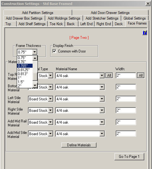

When I click on the frame thickness box, a bunch of different values appear for thickness less than .75, but no value greater than .75 shows up. BTW- when are you going to invite me over to your new shop?

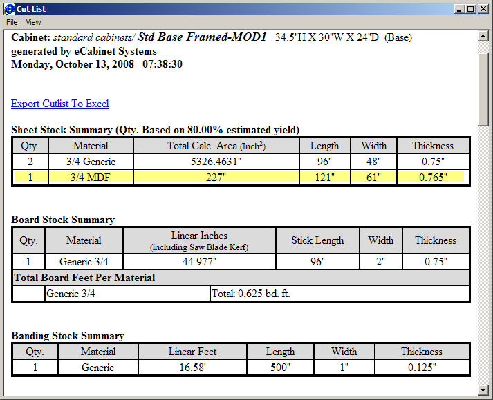

I don't have any problem choosing a material that is .765" thick for face frame components. Double check your material and make certain it is actually defined with a .765" thickness.
ff765 Cutlist.jpg (103.29 KiB) Viewed 9442 times

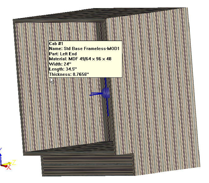

Try .7656
500x 600.jpg (61.31 KiB) Viewed 9410 times

I use decimals. Here is a screen shot. I am using sheet goods. I'll try what you said Forrest.
ff thickness prob.doc
(36 KiB) Downloaded 649 times
