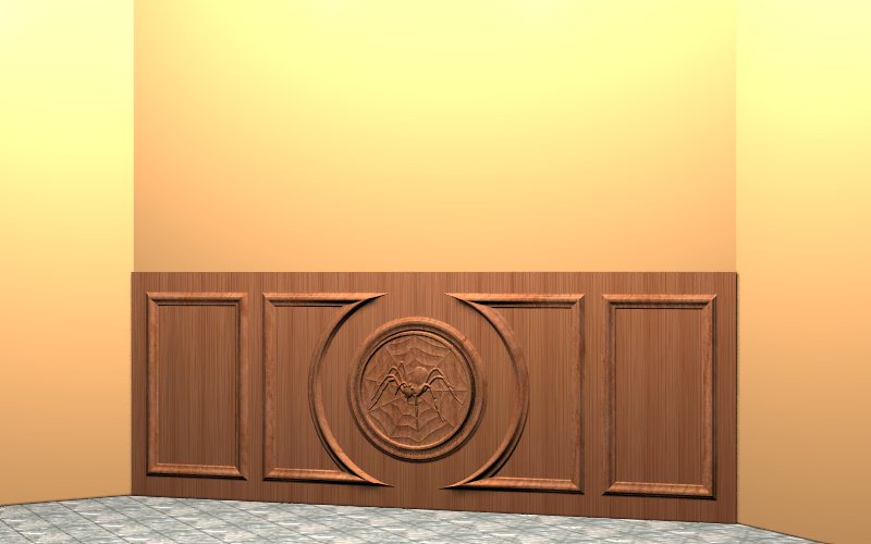

It can be done. If the individual grain direction of rails and styles is not a major factor, the easiest way is to model a part in the parts editor. Or you could do an applied molding with a big spider in the middle like this. :?
SPIDER WALL.jpg (43.91 KiB) Viewed 21924 times

Just got back home and cleaned up the spider webs off the wall. This is the other way of doing it.
SPIDER WALL2.jpg (27.42 KiB) Viewed 21895 times

The spider was created in artcam, the rest was just moldings created in ecab.
The last one was just a cab with the geometry drawn on the back of a cabinet and then move the back forward to the front of the face frame.
