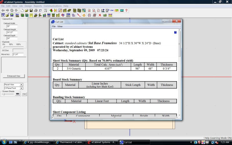

When I create a cut list I don't get the option to expot to excel. I am sure I have done this sence I got Vista. Where the heck did the Export to Excell option go :wall:

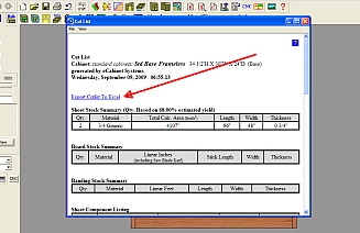

Gary,
The link should be Here

That's the problem the link is not showing up. I have tried to restart my computer and that did nothing. I have closed down eCab. and reopened it and still the link will not show up. I have not tried to reinstall the update for fear I might lose eCab all together.

Yes I did and it did nothing even the standard cabinets will not let me export to excell
