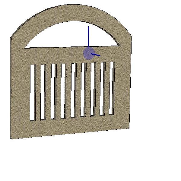

When trying to load a dxf file into PE to create a part ecabinets locks up. This same procedure is still working on my desktop which still has version 5 running. Anyone else tried this yet with version 6?

I don't seem to be able to load a dxf file. I get a note stating the dxf extension is not allowed. I can email it to you. The file I created was a simple 2
D design made in Quickcad from Autodesk which is an autocad based program.

Here is the file. It is not anything in particular just something I created to practice making dxf files.

I have no problems with the DXF file being overlayed on a part here.

I too was able to use the dxf file on my computer with version 5 still installed it is only when I use it on my computer using version 6. I quess this eliminates the file as the problem. I must have a problem with the installation of version 6 however, everything else seems to be running fine. At least so far. Does anyone suggest that I try reinstalling version 6?
