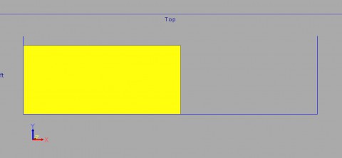

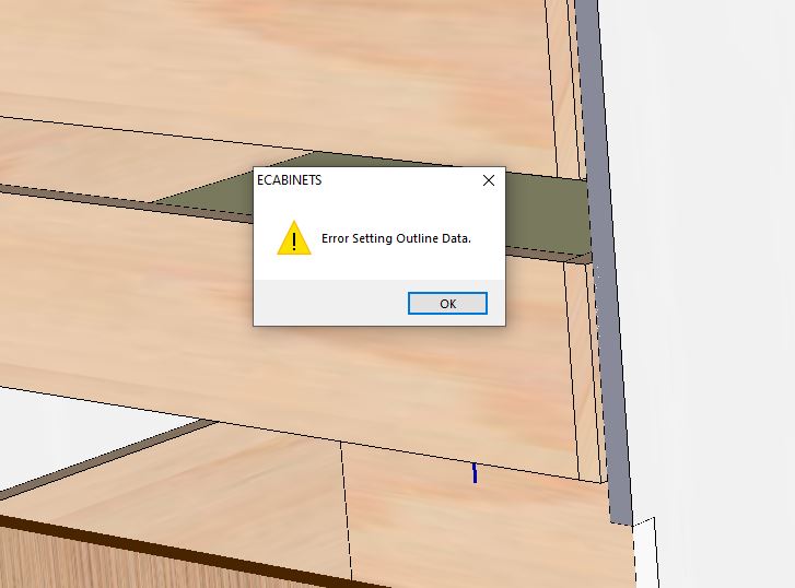

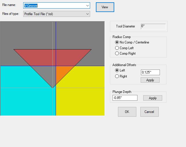

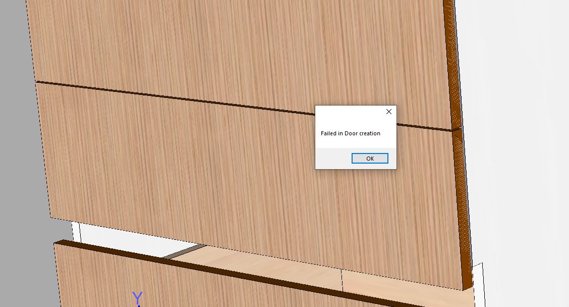

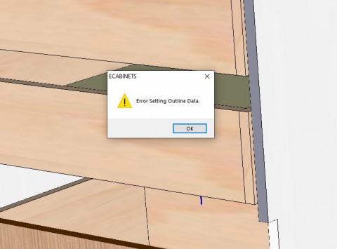

I have a big Problem since the new eCabinet version 12

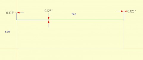

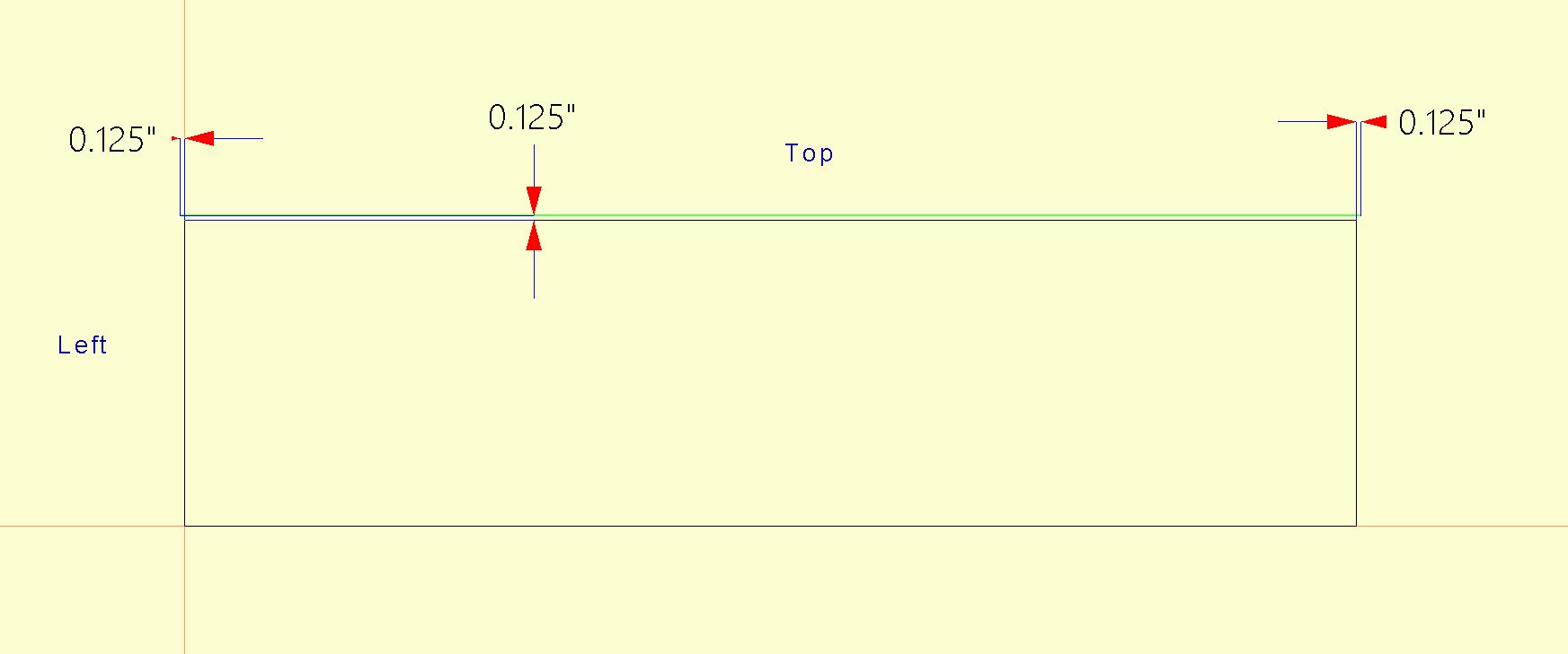

We are using a lot Profil 45 degrees (V-Groove) tool for our Doors and Drawer faces. Usually I add them manuel or in the Door designer with DXF lines (Create Edges). I am move the DXF 1/8 offset from the Part and made them 1/8 longer that the tool is cutting a little bit longer that the tool is passing more (longer) that I have a clean cut on the beginning and on the end of the parts. Also I am going 1/8 in the Wasteboard with the Groove to be sure to have a nice clean cut on the Surface.
Since the last update is the Programm always deleting my Door or Drawer face and has mistakes in it.
I tried everything to solve this Problem :wall: , like delete all Edit cuts, try the same with a entire another Cabinet. I want to keep to work the DXF tool line and we have lot in our Library with the same Method to cut 45 Degrees Door and Faces and we can not change that
Can someone fix this Problem because it is very important for us that works. I have a kitchen and all faces are 45 Degrees Finger grip and I lost already a lot of time and I am already late just because of that Problem.

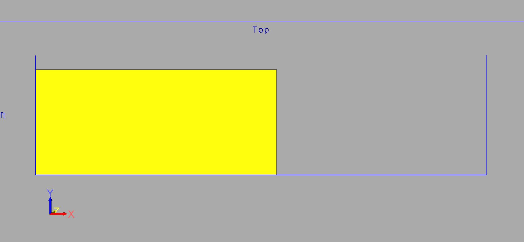

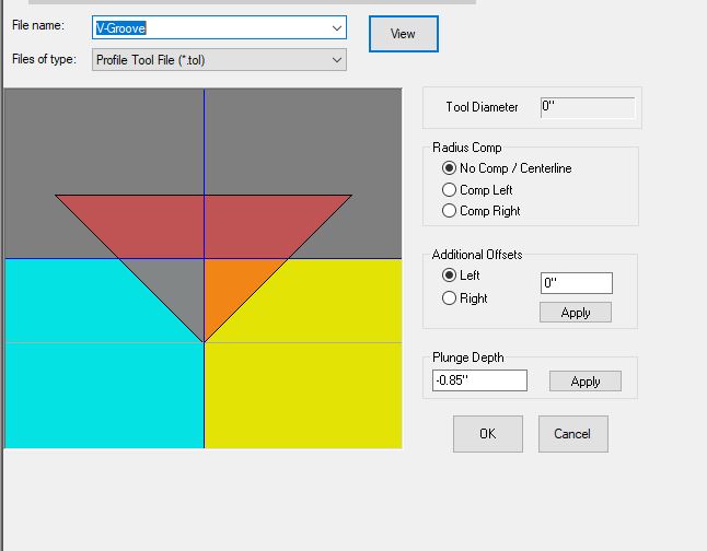

I tried it again and one with DXF line (toolpath) and one without DXF Toolpath (1/8 offset left and -0.85 deep)
I attached the Cabinets plus the pictures how i used the V-Groove tool without DXF
Nothing is working

Sorry forget to attache the picture for the V-Groove

Try removing the top drawer and adding it back then reapply the profile take it into the constraints manager and constrain the profile by right-clicking the Dark green edge with the profile then hovering over cut path attachment and selecting attach you may still need to constrain the 1/8 over cut also

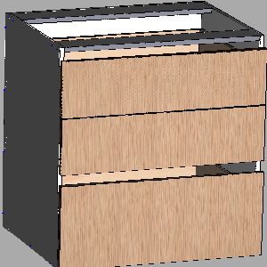

I am unsure what is going on with that top drawer, but this is what it looked like

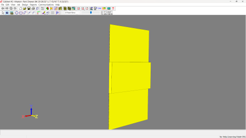

Good Morning
Thank you for your Cabinet.
I selected and open the first drawer face in Part Editor and you can see already that there is a Mistake defect in the eCabinets Software :( . See picture
Without changing anything is my Drawer face deleted and just the Edgebanding is staying.
Please note that in the Door Editor is the same Problem.
Please can the IT check that and update the eCabinet Software to solve this Problem.
We have to cut the 45 by Hand or have to use VCarve for it which makes everything more complicated and longer.

As soon as I tried to reload the door it was giving me a para solid error as shown it the short link after.
Anyway if we could get to the bottom of it life sure would be a little sweeter. :D
