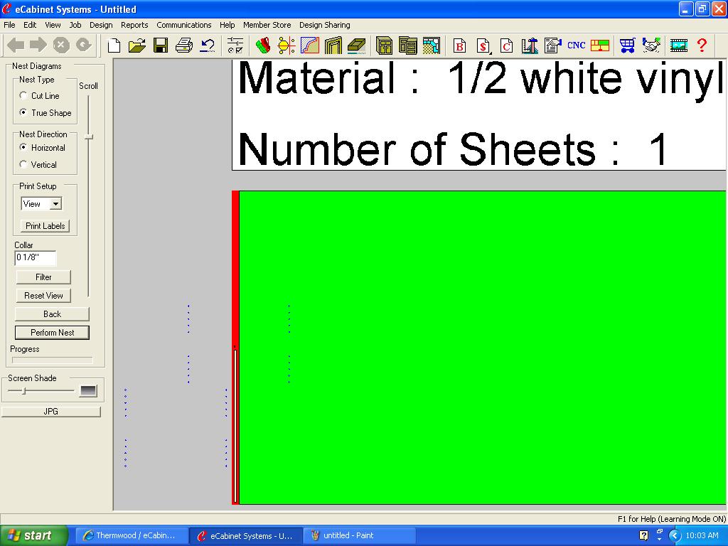

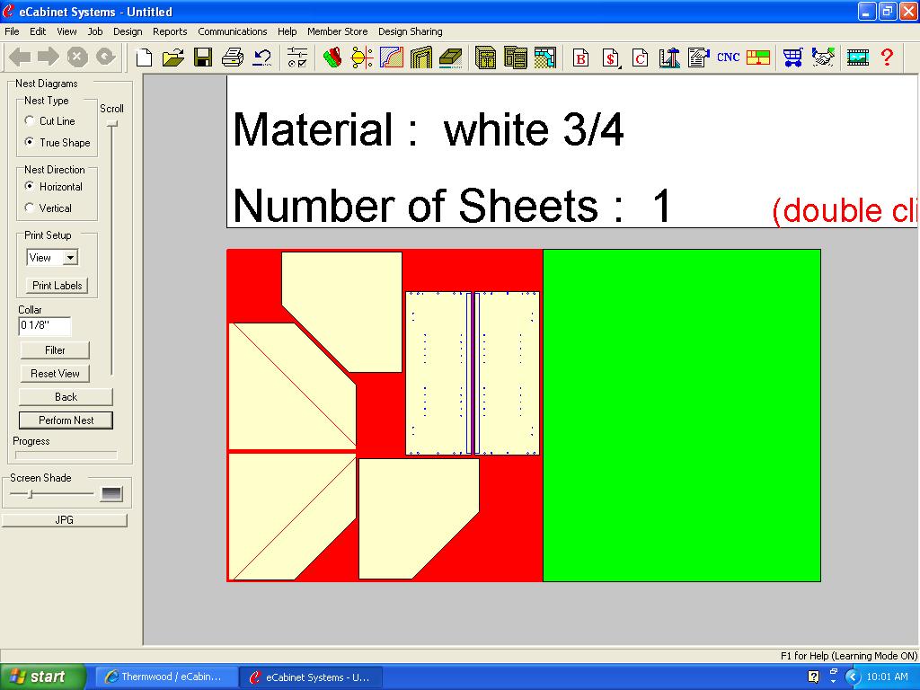

by Mark Hesketh » Mon, Jun 11 2007, 9:32AM
ok, if the nesting within ecabinets is any indication. this won't machine well at all. here are some screen captures of how the material nests. note the dado (?) across the top and bottom of the unit, and the backs are completely screwed... the holes start wayy off the sheet, etc.

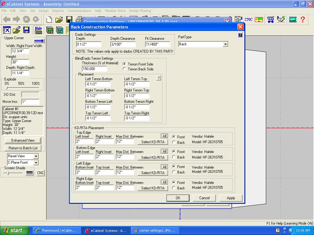

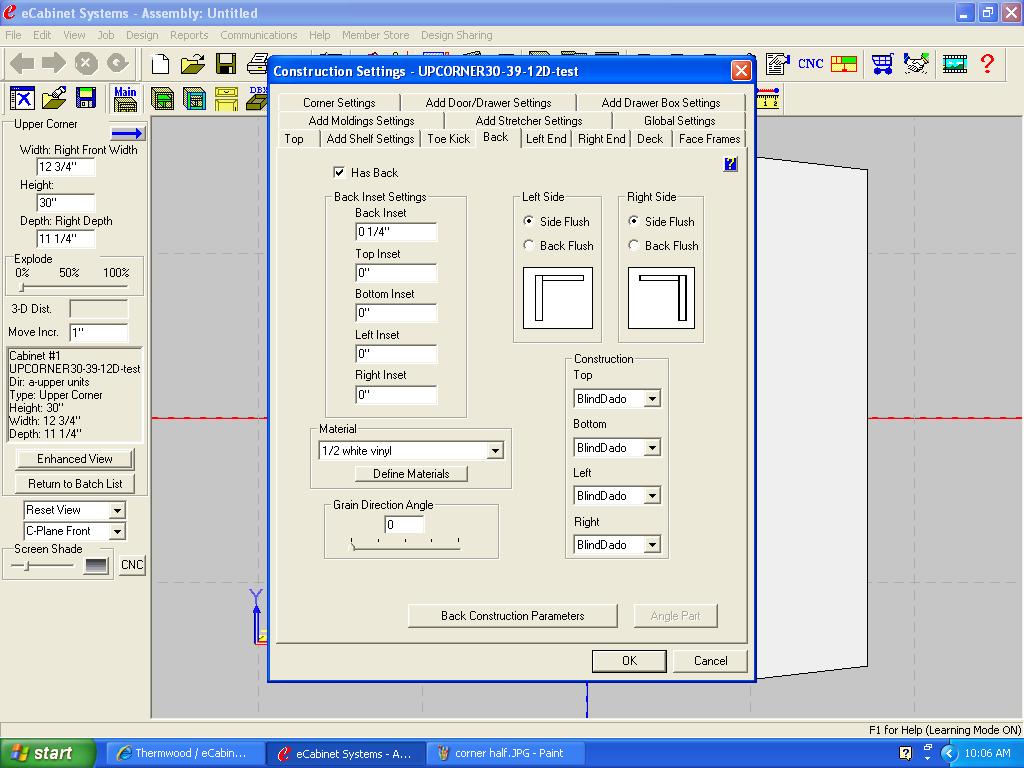

oh, and here are my settings for the backs
corner settings2.JPG (138.54 KiB) Viewed 9698 times

Posts: 5852 Joined: Thu, Jul 28 2005, 10:18AM
Post
by DanEpps » Mon, Jun 11 2007, 10:45AM
I had all of the tenon placements at 0\" instead of -1/2\". I don't know whether that will make any difference or not at the machine though.

by Mark Hesketh » Mon, Jun 11 2007, 12:30PM
tried setting them to zero, still get some funking looking nest layouts... and it also leaves the dadoes in the gables a little short
