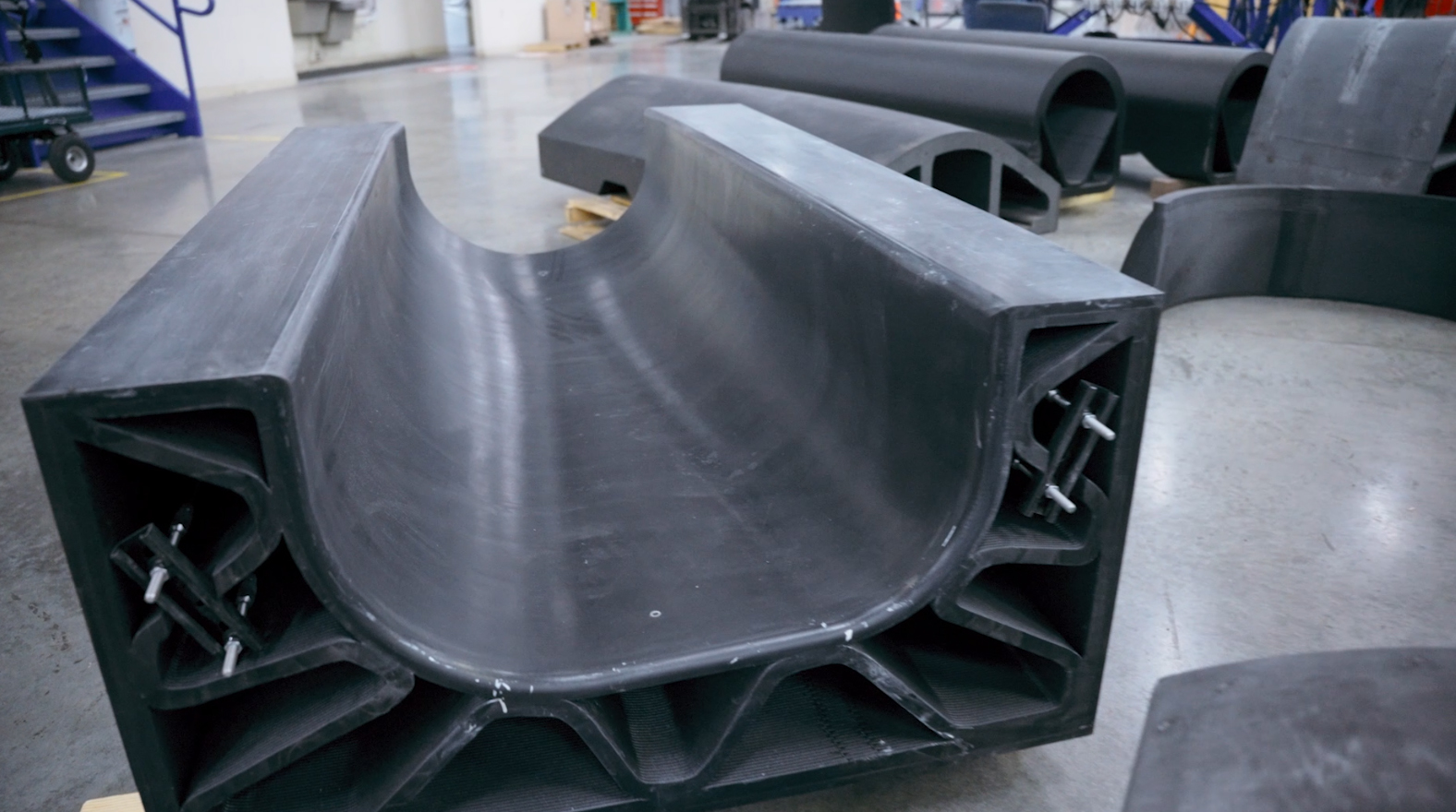

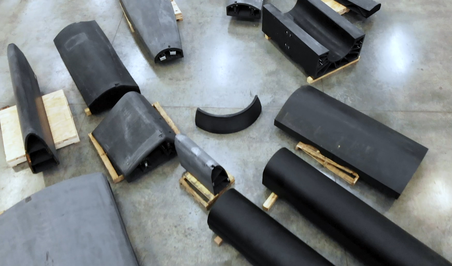

Stretch form blocks and mill fixtures printed on D-J Engineering's Thermwood LSAM
Large printed tools on the shop floor at D-J Engineering
Tooling printed on D-J Engineering's LSAM MT 1010
